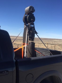

Not sure if I should admit that I only paid 400 dollars for this. A few days ago a friend told me that the fire department in a neigboring town was going to auction of some donated items from an old blacksmith shop. He had contacted the person in charge and was informed that there was going to be a hammer included in the sale. They had no idea about it with the exception of the name of the manufacturer. I was very surprised to find very few people at the auction and only one other gentleman even remotely interested in it. The bidding didn't last long. It was the most expensive piece sold today and I was happy to pay it. Seems to be in outstanding condition. I will know more with a proper cleaning.

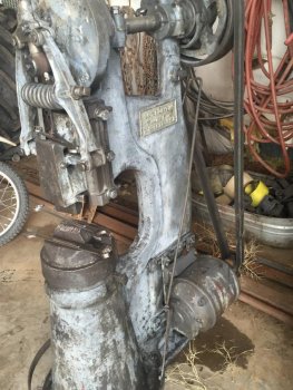

Darn the bad luck!! :) That's an awesome deal for that hammer!! That's what's known as an "old style" hammer (it doesn't have a sow block that holds the bottom die, and has the wrap around guide).
Give that old girl a little TLC, make any repairs needed (doesn't look like it will take much), and put here to work! Although it's been a number of years since I upgraded to an air hammer. I still have a soft spot in my heart for those hammers.

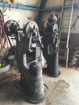

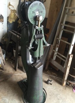

Gave this thing a thorough bath with the steamer today. Now I can see what I have. Fair amount on green paint under all that grease and grim. Everything seams pretty tight and nothing hinky looking. Pulled the three phase motor off and found an old motor in the back of the shop to serve as its replacement. See if I can get it running this evening. I still have a fifty pounder to go retrieve and give the same treatment. I'm pretty optimistic that by next winter I'll be able to put these to work.

Got the 50lb hammer home. Called Little Giant to get the age on it. 1946 model. Turns out I'm the second owner. Delivered new to the man whose shop I got it out of. An old blacksmith now deceased. It's new home is only seven miles from its original home. Pretty happy to gather up both machines so close to where I live.

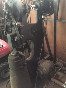

Thanks for the useful info Ed. I got the Fifty running today. Had it flinging grease/oil everywhere. Has the original motor as far as I could tell. Had to tear it down because it wouldn't run. Needs new brushes. I'm a rancher so improvising is what I do best. I super glued match sticks to the backs of the brushes so the springs could push on them, blew everything out with and air compressor, reassembled, and fired her up.
