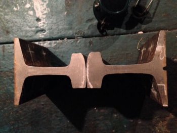

This converts back to log splitter by removing two bolts - Takes all of 5 minutes. I use it every year to spilt all of my firewood so its truly dual purpose for me.

I've got a 22ton splitter which I converted, but is sitting waiting for me to see how it works. Would love to see how you modified yours. I actually drilled thru the sharp part and mounted the die holders. took me hours to do that, but it does hold them well. Converting mine back to splitter takes removing a few bolts, but I have time. More pics of your set up please.

Wolfe - Controls are not changed in any way. The nice thing about this is the whole setup goes on and off easy and the operation remians the same.
