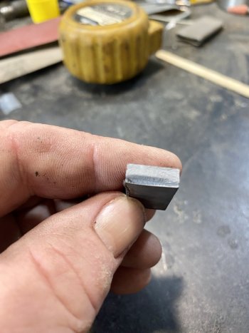

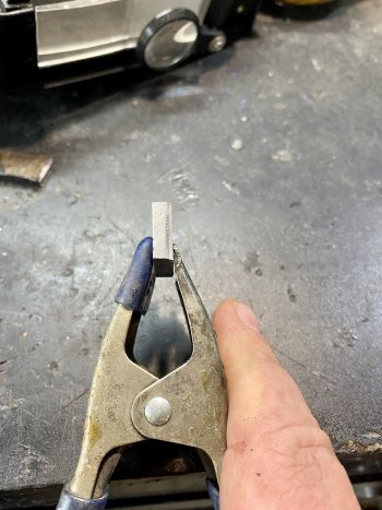

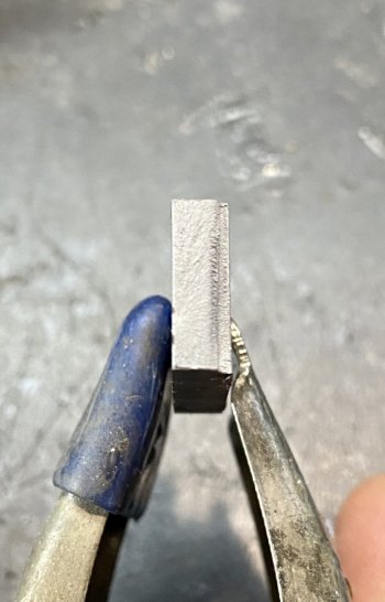

Coupon testing done. I took this piece as received (no refinement done by me) and heated it to 1650f held for 30min and quenched in heated canola oil. Judge the grain for yourself. It skated a file well too...that is the extent of my hardness testing ability. Other than my fly press snapped it fairly easy.

On the grain - from looking at photos they look like fine grain but it's really hard to tell from a photo. When you look at it does it look like a file or drill bit broken? That's how I check for fine grain - look at coupon and a broken file side by side. File MUST be one of the older high carbon steel types, not the new cheap surface hardened files.
For no refinement at all from me the grain looked really good to my eye and under magnification. I tried taking a picture through my opti-visor but it did not work. I am going to do more coupon testing with some normalizing steps but for a one shot deal it looked good. If I were doing a stock removal knife the results would make me happy. However. as we (the forum) have discussed before, even SR knives can benefit from normalizing heats.
Sometimes I think the lower carbon stuff kinda breaks and looks like tempered steel (like yours here) with a more "torn" appearance. I wouldn't expect a chalk like appearance myself. I am often wrong about these things.
I put the coupon in a fly press jig I have for cold bending 90s in steel. Snapped easily enough in the non tempered state. I am interested in what happens when I try to snap a tempered piece. I bet it just bends to 90.
