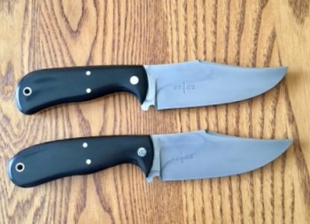

I’m working on a series of five knives from the same pattern, and applying the same heat treat with each knife. The blades are 1095, and were brought up to 1475 degrees in the kiln and quenched horizontally in an electric turkey fryer and peanut oil that had been preheated to 120 degrees.The attached photo shows the two blades after etching in a 70/30 mix of ferric chloride and apple vinegar and handles fitted. The edge retention and hardening on both blades is very good. My theory is that the horizontal quench caused the blade to harden differently, with the thicker part showing the Hamon line. Any other ideas? Thanks.

What thickness is the material? It looks like the peanut oil was fast enough to cool the thin sections of the knife but not the thick parts by the ricasso. How many blades did you quench before these 2? Maybe the oil was too warm to through harden.
Thickness is 5/32" at the spine. You'll notice the line starts at the thick part of the ricasso and ends at the beginning of the false edge where it's definitely thinner. I heat treated each blade separately, with a few hours in-between, while the electric fryer was set at a constant 120 degrees. It's possible the oil may have gotten hotter with each blade, but I believe I checked the temp of the oil with each blade.
Did you use a thermometer to check the temp of the oil or just the dial on the fryer? It looks like your oil wasn't fast enough to harden the thicker parts of the blade. If you used the dial I wouldn't trust it. If you used a thermometer you can test it's accuracy by making up a glass of ice water, and let it sit for 15 minutes. Your thermometer should read between 31 and 33 degrees.
I used a thermometer, but i’ll double check it for accuracy. Do you see any problem with the overall durability of the knives? Actually, I kind of like the lines as they add some character to the knives. Thanks for your input.
No I don't think your performance is going to suffer. I used to use canola oil for quenching and had that happen a couple of times. I finally bought some parks 50. What a difference it made in the ease of quenching and getting repeatable results. It seems like a lot of money but the heat treat is the heart and soul of a knife. Not saying you're doing anything wrong but it definitely makes life easier.

That's just 1095, its a shallow hardening steel. I get that sometimes too, really shows up on a sand blasted finish.
Of any of the natural oils, that I have done testing with, peanut oil has about the slowest cooling curve, it has a higher flash point and that is why it is preferred in these deep fry units, but it will not through harden 1095. Canola is faster but, as has been mentioned, something likes Parks#50 is fast, consistent and stable. When doing a horizontal quench I always try to hit the oil spine first to five the thicker blade portions a head start in keeping up with the edge in hardening effects. It can avoid reverse sori (curvature) and some of the hamon effects.
