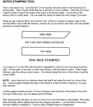

D. RANDALL
New Member
Chris. I made a stamp like the attachment. if you want a longer nail nick just walk the punch until you get the length you want. I use the punch before heat treat.
you want
