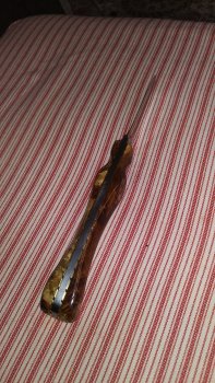

Here's an example of a knife that I just got frustrated over. I burnt the steel while making another style blade so this piece came from a failed attempt at another style blade. this thing just looks all out of whack to me. But I can't nail down the problems, one of the reasons I started this post. sorry for the bad pictures please critique the hell out of this thing and tell me why it doesn't please my eye. be brutally honest I can take it.
two of the things that bother me about this blade is how narrow the handle is, and how straight it is0309191009a.jpg

Couple of things I keep in mind for every knife I make:
Ergonomics. I don't particularly care for handles that lock my hand or fingers into one specific position, unless it's a very purpose built piece. Along those lines, I don't like blocky handles or handles with hot spots.
Geometry. I used to make my edges thicker for toughness, but as I've made and used more and more of them, I've started to prefer a thinner edge. Again, build your knives to the purpose you intend for them, but 9x out of 10 I'd rather have thin and sharp than thick and sharp. I also keep the width and length of the blade in mind. Most cutting is done with the first inch or two of the knife. Is the point sharp? Is the forward edge in a good position relative to the hande? I suppose this can tie back into ergos, as it's certainly is part of it, but it's kind of its own thing as well.
Aside from that, the rest mainly boils down to balance and aesthetics.
0309191009a-jpg.67920
OK so here is my take. I am more of a traditionalist when it comes to knives.
I hope you meant the above statement and please take this as constructive criticism!!
I copied your picture and made some changes! I wish I had a better drawing program than I do so I had to do this in the only method I had to add some lines to the knife!
It appears you have a dagger grind. Save that for a dagger! The area the is commonly called the Ricasso has some grind lines. The entire blade should be finished before you attach the handle!
The handle needs more flare to the back end! I can't believe I am about to do this but I am going to quote a problem that is commonly addressed when on FIF! A skinny handle is hard to hang on to. Especially in a chopping operation! I will say this I love the handle material! A good rule of thumb for a handle is 4 1'2" - 5". It depend on the hand holding the knife!
I like the back edge of the blade to be in line with the top edge of the handle!
I like a drop point on a blade. If you do a drop point and raise the bottom line on the blade. It creates more of a point. That point can be extremely useful on a multipurpose knife!
Take your grind line up close to the back, maybe a 1/4" from the top and make your plunge line straight. Some like to keep it straight but like to angle back towards the point!! If everybody liked the same thing it would be a dull world!!
None of these things I have mentioned are locked in stone! I have seen a dagger grind on a knife, with a handle such as yours! When using a handle like yours I like to keep the back edge. To me I don't like it but diversity is what makes the world go around!!
You have got to like your design if you don't you will never be happy with the finished product. This goes back to a drawing to scale!! It gives you a look at what you are about to create.
There are others on here that have far more experience than I do and they can give you pointers in other directions!! These are a few things that popped out at me!!

I think I'm trying to be too fancy sometimes and get things out of proportion. Thanks for your opinion it helps.
your post was fantastic! Lots of good information I'll be able to use, which is what I was looking for, thank you again.
