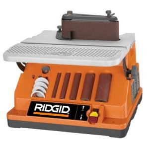

I bought the stuff pictured pretty cheap today. Not really sure what I can use it for but I couldnt pass up the price. Any ideas ?
Ocillating spindle sander: I have a nwg built so not sure what I would use this for. Any ideas to help me keep it.
Belt sander with flat disc : This is all I really wanted but he kept throwing in the other stuff. I mainly wanted this for the disc sander but im sure i will use the belt some.
Squirrel cage: Maybe move some dust out of the shop..??
Dewalt router : I have no use for this and will probably sell it unless someone has an idea for it in a knife shop.

I have seen them used in place of a horizontal grinder to get in the tight areas of the bottom handle and around guards . They are useful.
BruceM
I'll use my spindle sander quite a bit on the those inside radius. Pretty handy sometimes. Found a bunch of AO sleeves on ebay cheap.
NickWheeler
I got mine before I had 3 belt grinders all rigged with small wheel set-ups... but I still use it now and again.
The thing that is so great about it, is that you will get your radius/curve EXACTLY perpendicular to the part. :)

I have one I use for grooving and texturing scales.
-John
I haven't thought of that. I have been wanting to try that since reading bill coyes tutorial on it.

I've had an oscillating spindle sander for quit a while, but I upgraded to this. A combination of both spindle and belt.
I use it for the same stuff, but I can get the tops of the handles perpendicular, too.:D 2thumbs
I use it a lot.

Spindle is great for radius and grooves as was stated before. that large flat belt 6x48 I used for taking scale off a piece over a foot long in about 8 seconds at 80 grit.

After watching MO and Bill turn out them finger choils/thumb grooves with them, I am debating picking one up myself. Sure would beat using my slow speed drill presshuh1

I used one until I wore it out in no time at all. In the end I found out the one I had was quite flexible . What happened was I got curves that were different at the top from the bottom. What I went to and works excellent is an inexpensive plunge wood router with a very inexpensive table, I also bought one of those speed control switches to use with it. I start with a 60 grit drum and then 320 . I operate it at a slow speed. I do lots of curved bolsters. To see sopme of my work, go to customknifegallery.com and scroll down on the left hand side to my name. Frank

That's interesting since I have two routers pictured I don't know what to do with. I will have to go your site and check out your knives.

I have a RIGID osc spindle sander from the DEPOT and I must admit, I used it all the time. Tight radii and choils are easy pickins. If you need to hog some scale material down close to the shank, put in a 1 1/2 x 60 grit drum and say goodbye to the scrap. I also have learned to roll the finger detents in shaped scales.
I posted a tutorial on scalloped bolster inserts and you can see mine in use.
They are also great for putting a spiffy hollow grind on wood chisels and planer blades.
