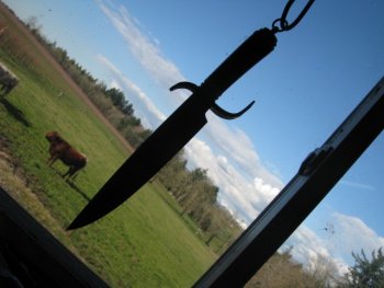

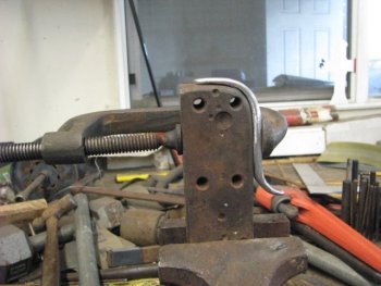

I've always enjoyed making bowies and fighters with "S" guards. Been using this trick for several years. Clamp the guard to a chunk of 1" wide steel, stick it in a vice, heat the guard material with a propane torch and hit it with a hammer a few times till it conforms to the die. The second photo should help.
That’s a great method. I think I need to invest someday in a big boys vice and mount it too something real solid. I bet you need no movement in that vice. I really like the silhouette picture.
