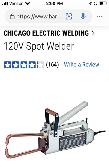

This is the second time in so many days I have heard mention of spotwelding the bolsters on. What are you using to do that?
spot welder machine from Harbor Freight.
$159
