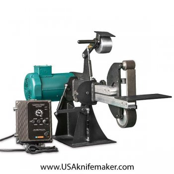

I’m not sure what some are seeing, but this is what USA Knife is selling: I certainly would not say the maker has “no experience”. And I would trust that Tracy takes some pride in what he sells on his site. In addition, my eyes could be deceiving me, but THAT looks like a KBAC VFD in the picture, RIGHT FROM USA knife maker. And saying a TW-90 is cheaper is unequivocally, and flat out **WRONG**!! I was no math genious in my school days, but when the TW-90 costs $3,600 & the Black Fox One costs $2,499, well according to even MY mathematically limited knowledge, that would mean it is in fact the Black Fox One which is CHEAPER. BY $1,101 to be exact!!! (Did I get that right?)
Yes and no. You got it right considering you only looked on USA, but no in that you failed to actually look at the products website, and made a lot of uninformed assumptions along the way.
That's kinda the issue with this machine...... it's simply not finished/in a finalized design.
1. On USA site it shows the KBAC controller, and if you look on the actual website for the machine, it show images and talks about "VFD parts" and shows the VFD components housed inside the machines frame/structure.
2.The other clue is that as it's listed on the product's website, the cost for the "pro" version (which most closely resembled the TW90) is indeed several hundred more then the TW90 (as in $4449.99).....
With all due respect, I try very hard to be as polite and tolerant as possible, and offer advice/help as much as I can, and hesitate at this........ BUT for some reason you seem to just wanna be antagonistic and demeaning in just about every interaction I've had with you on these forums....... So, before you jump into "dogging Ed" mode, you might wanna get YOUR facts straight, and consider your own "incorrect statements" before dogging someone else. I might disagree with others from time to time, but that disagreement is based on experience and time at the craft, and those things associated with it...... I do not dog, belittle, nor demean others for their insights and opinions, and would appreciated the same courtesy.
Here's a link to the grinder's website..... https://blackfoxknifeworks.com/knifegrinder?category=2x72 belt grinder What I suspect is that on USA site, it's the first iteration of the machine, as the pic depicts the frame being welding, along with the KBAC controller....... The bottom line is that this machine is obviously not "finished", and that alone should be red flag to potential buyers....at least until the design is finalized.

wish I could see one in person. some thoughts looking at photos and the website
it is awfully tall and the motor is not supported by anything but its face. a C face motor will be in the 20-40 pound weight range. there is no way to support the motor. some pix show base mounting holes, some don't. with the motor mounted this way, you will need to bolt the grinder down
handles are ok in some places, no so in others. to hold the tooling arm, I prefer grade 8 socket head cap screws. handles have too many moving parts and cost several times as much as a cap screw.
i see work rest and platen but no tooling arms at all on the site.
i think there are better options out there.
unless you gotta have one today, wait till January and see the new LB1000 and other Wilmont offerings
A c-face motor will be fine mounted solely from it's face. It may not look like four 3/8" bolts would be very secure, but it is excessively so (assuming proper thread engagement).
Shear strength of a grade 2 (low strength) 3/8" bolt is about 5000 lbs PER bolt. To shear all of them at once, you'd need 10 tons of lateral force. Tensile strength is orders of magnitude higher per bolt (about 74,000 lbs EACH). Proof load (force needed for ANY initial plastic deformation) is a little bit less, but still about 4500lbs per bolt, or roughly 10% less as a rule.
As for the absence of mounting holes, most of the pictures on his website are CAD renderings, not actual machines (which makes me wonder how many if any have actually been produced and tested).
I know mounting bolts will be ok, just a lot of weight in the air, if not bolted down the whole thing will tip over. also looks like whole assembly can move, a lot of weight for two small screws. i went with overkill and used grade 8 bolts to mount my motor.
I wonder that also and how it will actually perform.
