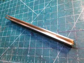

Hello All - I was able to make the general shape that I was looking for by rigging up my pneumatic cut off saw perpendicular to a cross slide vice and slowly mill it (sometimes my crazy ideas actually work!).
Now for the hard part. My plan now is to heat up the brass with a torch and then pinch the bottom closed. Perhaps use a vice to bend shut.
Question is can I “harden” brass? I found the brass at a junk yard and it’s fairly soft. I think it might be 360 Brass. Thoughts on a process?
Thanks!
