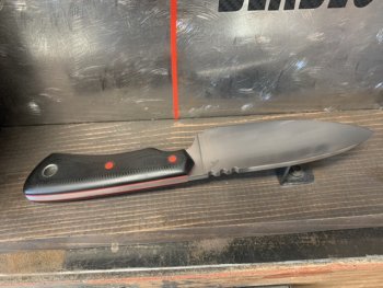

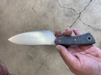

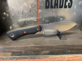

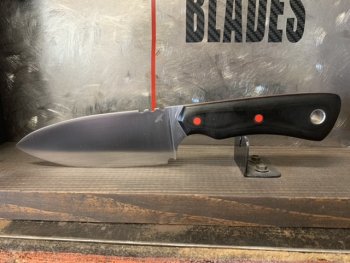

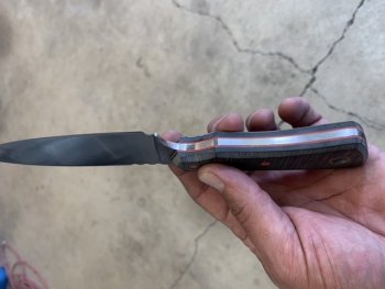

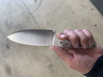

I cut this blank out a while back and have worked on it periodically. 1080 with a 9” OAL. Belt sanded to 120 then hand sanded from 120 to 400. I’ve been working really hard on my hand sanding and this is definitely my best to date. Still not perfect but I’m very happy with it! The handle is black G10 with red G10 liners, red G10 pins and a stainless lanyard pin. I can’t wait to get it completed!
