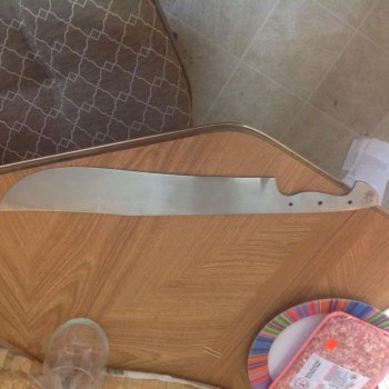

As requested heres the pictures. I hope they are clear enough. Overall 22" long the spine is 3/8 thick the edge is 1/8 1084 steel distally tapered. I also included a screenshot of the 3m scotchbrite pads that were mentioned. Are these the right ones and how many should I order ? Is there a way to do this without the pads ?
Sorry the reply took so long. Been a rough week.
image.jpgimage.jpgView attachment 55424View attachment 55425View attachment 55426View attachment 55427

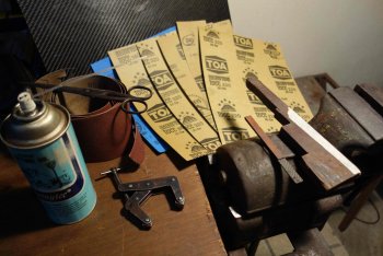

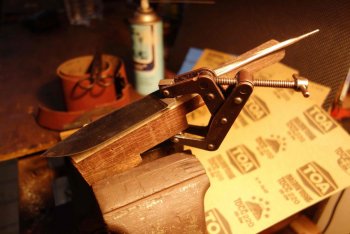

This was I need to get a good finish.
Grit 220 / 240 / 280 / 320 / 360 / 400 ....I work in smaller steps in grit size....I get a cleaner even finish in less time.
...it took me a few years to really see whats going on on the surface and in the light,....today after I am to grit 400, I am 80% really at grit 400...and on a real 400 it is no effort to get a grit 600.....
a simple stepped wood piece, about 220 mm in length and 15 mm in thickness, blade should be wider
a good paralel clamp
a piece of wood(140 x 10 x 3 mm) one with hard leather glued on, leather thickness about 2-3 mm...I prefer a piece of 2 mm carbon it wears not so fast down as wood, for bigger blades of course a bigger one
cutting oil
and for removing more material if it is needed
a fresh, sharp 150 grit grinding belt...
when new belts come in the house, I always sacrifice one, it is worth it 10 times!.....I invest 10 € in a belt and have nearly a year long the strongest, most removing hand sanding stuff. with cutting oil an even good pressure it is on big blades for me the fastest way to prepare a real fine finish....
and a paper scissors to cut clean stripes as wide as the small finishing wood.
this are the tools only
so far so good
hope that helps

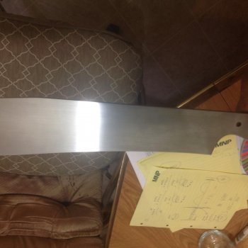

image.jpgimage.jpgSorry the spine was a random side thought lol I was looking at it at the time I posted and thinking to myself is this too thin already.
These were some of the pics that were invalid. Idk why... I see links on my end and they open into the pictures. Its odd.
Thanks for the help though! Im getting some idea whats going on. In the light it looks streaky. To me it looks like some of the sanding scratches are deeper and some are finer. Im wondering if perhaps I didnt get the marks from the coarser grits out as much as I had hoped. Im going to try sanding by changing directions as was mentioned and see if that helps.

the pics are to unclear to see something.....there it looks like real cool satin...lol.
What is that for a steel You used on the blade?
it is very important not!! to practice satin finishes with D2, CPM, elmax, ATs....take something that is easy to remove and work with like O7, or 52100, 5160...or whatever but not that full alloy packed stuff....
and satin finishes on such big blades like Yours are not easy to get even....so if You want to have a nice finish think twice if it important for You to make it satin.
satin finishes have more friction they make a blade cut less agressive and the coarse opened surface rusts faster and/or holds a lot of dirt and remaining stuff from cutting, like wood smear and the like.
