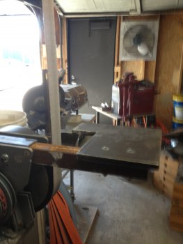

I have used one for over 10 years. Yes, I would like a 3 wheel upgrade, but you can make very nice knives with the Coote. I made the attachment shown.

Dug up this picture of mine when I set it up. Not saying it’s a great design but you can see the contact wheel is free hanging.
