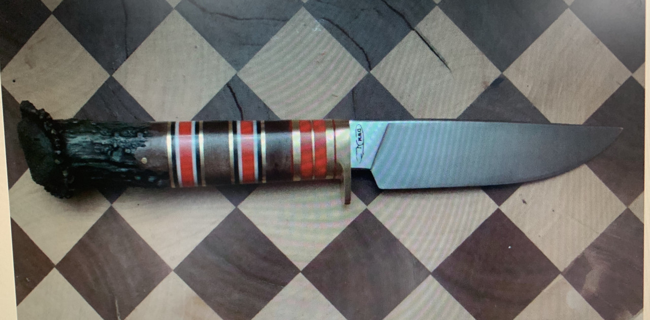

Not the best picture, but I have used it before. If I had a better source, I will use it again. The red spacers in this handle are corian.
