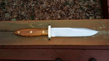

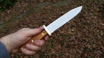

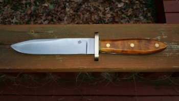

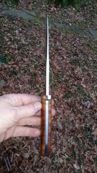

Just finished this one today (funny how it comes and goes, work for a few weeks, then a handful of finished knives to show off, haha). Anyway, 5160 steel, Rc57/58. Tiger maple handle scales treated with Aqua Fortis and heat for color, finished with a mixture of linseed oil and shellac. Brass guard and pins. The false edge is not sharp. Hope you like it.

I like old school knives. How did you fit that guard?
Chris, the handle/tang is just slightly smaller across than the part of the ricasso the guard fits over. I did have to beat it to get it into position; holes were previously drilled thru the guard and blade when initially fit, prior to heat treating it. I like old school knives alot, too - and I solder on guards, old school style!
