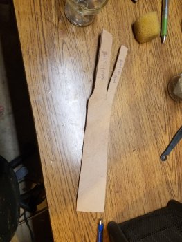

On this one, the strap is integrated in the back slab of leather. When I cut the back piece, I laid out a long strip for the belt loop, and a strip beside it for the retaining loop.
Ok thats what I was doing too but was wondering if there was another way to do it? Other than skive and sew a piece on. I think the sheath would start getting to thick doing it like that?

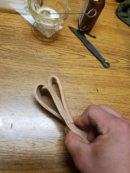

Hopefully this will explain it better. I remembered I had a scrapped piece left from this sheath, that showed it perfectly.
The back slab of the sheath, I normally have the long piece for the belt loop coming straight out, as part of the same piece of leather. For this one, I shifted it slightly to the side, and then cut a second thinner strip for the retention strap.
Lmk if these photos don't explain it better than my words can. I would get photos of the actual sheath, but it's gone now.

I’ve used that method before but I looped the retention strap to the front side-the bottom is shaped like an upside down T which becomes part of the welt.
