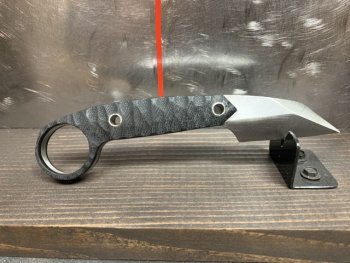

I’m making finger holes. I have made a few of these now and have been looking for ways to more efficiently cut the finger holes out. Inside diameter on these is just slightly bigger than a quarter. I bought a couple of the step drill bits some of the guys mentioned and they have worked great for me so far!
