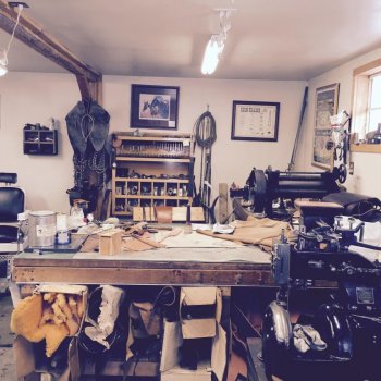

slatercreek
Most sewing machines marketed for leather these days are no more than glorified canvas sewing machines. A true leather stitcher is a needle feed machine without feed dogs. That way you don't mark the leather. I'm a saddle maker also. I have three different harness stitchers in my shop. All designs were patented in 1890's. These were made specifically for leather. Nothing can duplicate something that has been hand sewed. I have seen some beautiful knives with some sorry looking sheaths. I pretty sure many knife makers don't know the proper way to hand sew. It takes minimal time with minimal hand tools to do a beautiful job. Just need to know the proper technique. That being said my work horse is the Randall hook and awl harness stitcher located in the corner of the picture. Everything in my shop gets a stitch groove. Machine sewed or hand.
