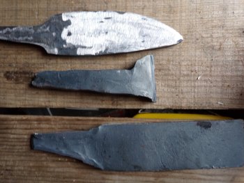

Twinning will not be black, and you will need to know what to look for to find it. I know the lines you are seeing, it comes from reducing a cross section too drastically during forging, some alloys are more prone to it than others, what steel is this again? I have found that chromium bearing steels are prone to the black stress lines during reduction when pushed too hard. Sometimes they are only a surface feature, but even then the strain effects are hidden under the surface. Try normalizing and these cleaning the area up to see if there is any disturbance in the metal still.
The steel is 80CrV2. Might have been a mistake to use this steel as beginner steel.
I could see this might be what I might have done if the steel was too cold or if I might have too light of a hammer. The steel is 1.5" wide - not sure if that matters or not.

I snapped this photo before I left town. At the time I had 4-5 knives I forged that all turned out with some variation of this:
There are the black lines I mentioned on the spine of the first. The knife is upside down.
The steel looks rolled over and folded on the second specimen which is a tang I cut off. ("Dislocations"??)
The same thing was happening on the third. That's when I decided to stop. The bar stock is 1.5"
