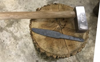

tkroenlein
My wife bought me the handled version of this for Christmas. She creeped me on a FB blacksmithing group and asked another member, and he recommended this.
It does indeed need cleaned up. Which makes it like every other hammer I have. But it seems to be as hard as a hammer needs to be with no remarkable issues.
I use it for most forging. The only time I use a different hammer is for drawing something a whole bunch with the rounding hammer when I need a ball pein for something.
I really prefer the dogs head pattern now. It's just a more natural relationship between handle and work for me.
I used it just today for this.2F2F39D8-5393-44D4-BECB-9BD87C8700EA.jpeg20952F68-14F1-4FAC-9712-E7DBE7C42886.jpeg
