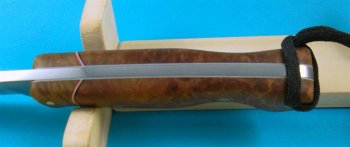

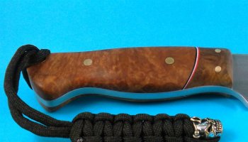

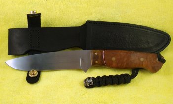

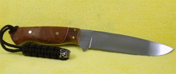

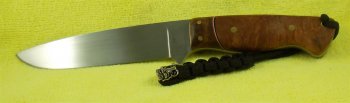

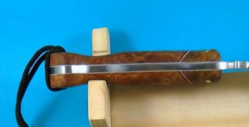

Hi all,
This is my latest work
Made from 52100 High carbon Bearing steel, H/T Aprox 58 Rc.
Stabilized Australian Coolabah burl handle with White G10 liners and brass pins. Stabilized Australian Greybox burl bolster with Black, White and Red G10 spacers and Brass pins. Brass lanyard tube.
Handle has been contoured and is very comfortable in the hand in all positions.
Blade is finished with a 800 grit hand sanded finish.
Full flat ground blade.
Black paracord cobra knot lanyard with "pirate pig" skull bead.
Hand stitched and embossed leather sheath.
Knife dimensions
135mm blade length.
30mm at the blades widest point.
4mm at the blades thickest point.
115mm long handle.
250mm Overall length.
This is one of the best that I have made to date and it is for sale if anyone would like to make me an offer!
Thank's for looking, all comment's or critique are most welcome!
