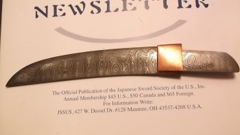

bubba-san
I think what you may be referring to is extended tempering after etch. This particular blade has 6 types of steel in it . I cant really see much color difference , just shades of grey and black.
But, if you do some long tempering cycles steel will change colors , like red, blue ,purple ,orange depending on the steel . The only problem I found with color treating was a slight decrease in hardness and edge holding. other than that it makes some colorful blades .......... Bubba
