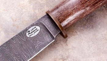

Here is an example of how I etch my name on Damascus. Before etching the Damascus in acid I hand sand to 1000 grit,then I use my electro etcher to do a deep etch with AC voltage then blacken it with DC voltage.I mask off all the areas I don't want acid etched with fingernail polish,three or four light coats instead of one thick coat,then I let dry overnight. The deep etch of my name is completely filled with fingernail polish,I take a razor blade and slice off any polish that is around and above the surface of the etch,I then use a jumbo black sharpie marker and put a thick coat of that ink over the fingernail polish,let it dry ,then LIGHTLY sand over that with a perfectly flat steel sanding block and fresh 1000 grit paper to remove the excess sharpie ink. After etching the Damascus in acid I place the blade in acetone to melt the fingernail polish.

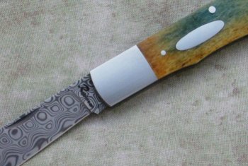

Here is another way to do it that looks good on bigger blades. I hand finish my Damascus to what ever grit I desire then I use foil tape and cut out the shape of my logo area,stick it on the blade then etch the Damascus. After the acid etch I peel off the foil tape,usualy only the glue is left, then electro etch my name inside this unetched window I have created.

Calvin, is the sharpie step just you can see where your sanding? Or does it help some other way?
Anthony,
The sharpie is a good resist by itself but I don't trust it alone after putting so much work in a blade. The sharpie ink is really thin and fills any microscopic cracks that may be around the edges of the logo etch. It's kinda like wearing a belt and suspenders to play it safe.
