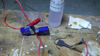

I use Ernie's stencils and simply connect 2 9 volt batteries together. It takes a little longer...like 4 or 5, 3 second reps in intervals of 10...but it works. I took the end of a file (the small handle end with just enough of the flat of the file still attached) and attach one alligator lead to it with a piece of old t-shirt as the pad...works much better than the qtip. I also switched to using knifedogs etching solution and find that it works better than salt water. It's cleaner and crisper. After the etch is deep enough, flip the leads and it will blacken the mark.
Trust me when I say I've tried the cheapest ways possible. If you use Ernie's stencils, or similar, you're going to want a little better method of delivery than the q-tip/saltwater method. It burned up stencils quick for me which gets expensive.
I can give you some pics of my "as cheap as professional looking etch should get" setup if you would like.

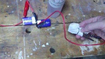

Ok,
1. connect 2 9 volt batteries
2. positive lead goes to the knife, negative to the file end (my etching pad)
3. wrap t-shirt piece around the flat of the file one layer thick
4. secure with twist tie
5. squirt just enough solution on pad to make it damp, wet, not dripping.
6. hold pad on stencil for 3 seconds, 10 times, take a few seconds break or you'll burn up the stencil.
7. repeat steps 5 and 6 until etch is as deep as you like, I go for at least 4 complete cycles, maybe 5 to 6 depending on battery life (they last a while)
8. reverse positive and negative leads and do it backwards for a few cycles to blacken the mark.
I also use the grinder to take the rust off the pad (file) before I start. Use scotch tape to secure the stencil to the blade...this way you can actually lift one edge to check the depth and put it back down to keep going if you need. My avatar here^ and plenty of examples are on my facebook page pics, it works and it's cheap but may take a little practice...practice first.
I hope this helps!
