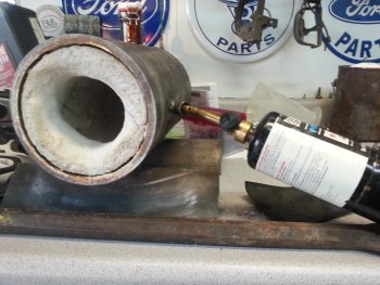

Hello, I am new to this also. I made one silimar to what Rudy described. I have only tried it once, but could not get it hot enough. I tried both Propane, and Map gas. I used a 50/50 mix of plaster of paris and playground sand for the liner material. I used a standard propane torch. Do i need a bigger torch as shown above? How long should it take to get to temperature? Thanks for the help!
- Jason

Jason,
You're problem may be that the forge has too much interior for the btu thrown by the torch or the mystery mix is absorbing the heat. I've never heard of the plaster/sand mix but if it didn't blow up.....you're ahead of the game. Is this mix over the ceramic blanket ? The torch shown is discontinued (JH-27) but it still runs off of the small propane bottles. On my forge the cavity is only roughly 3 3/4" round by 11" deep and the torch has no trouble getting the interior to yellow within 8-10 minutes. I noticed a difference when I started pitching the burn tube just a smidge towards the back half of the forge and moving it forward towards the front. The burn is concentrated and contained in the back half of the forge .
Rudy
Rudy, thanks for responding.
It is just the mix, no ceramic blanket... If I remember correctly, the interior space is about 4" x 16". The port is in the middle of the tube but canted towards the back.about 30 degrees. i am willing to redo the liner, re-weld the port, or a combination of both to make it work, just not sure what to do?
I'd look into re-doing the delivery system first. I built a Reil type venturi burner (google) for my 20" forge with all big box store cheap parts, which delivered plenty of ooomph just short of welding heat and better control. I am dubious of the plaster/ sand mix , stick with the tried and true. 1" ceramic blanket, high temp mortar and maybe some ITC-100 or plistix. Move the burner tube forward last if it isn't behaving properly. It all depends on your needs and how serious you are. As it sits, you should at least be able to get HT temps from your forge with a little more fire.
