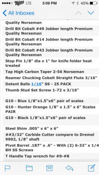

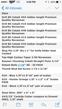

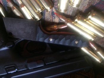

and im making a frame lock. A friend has a mill but he only has 1/4-1/2 bits And no cut off wheels. Ive nade fixed blades. Below is what i ordered from u guys.
