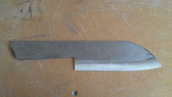

Just looking for tips on grinding bevels. This one has a wiggle at the base that's driving me crazy, and I haven't been able to get rid of it yet. This is pre-HT and polish, so there's still time to take care of it. Blade is A2, 5" long, 1/16" thick, and 2" wide.

I've found that if the "wiggle" is small enough I can sand the flats with sandpaper on a flat piece of quartz countertop. Depending on how deep the "wiggle" is sometimes this will sand it out.
Thanks
Im hoping thats the case here. I went over the flats w/ 220 grit paper and the wiggle changed.
