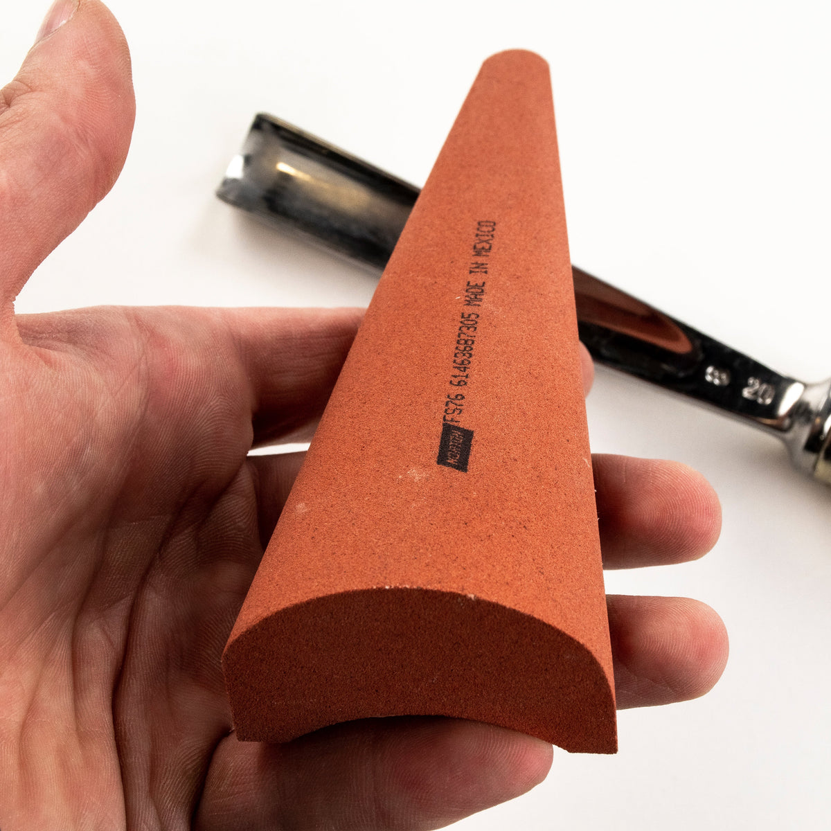

For sharpening stuff like that, I usually end up wrapping sandpaper onto a file or a dowel.
If you want something fancier than that, I suggest looking into stuff for sharpening carving tools and lathe tools.
