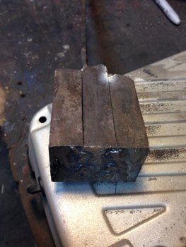

I usually use a longer piece of the actual stock as my handle so the handle is part of the billet and not welded on. When done, I just cut it off.
I forgot picture - In this case the handle is just a long piece of 1084 that actually part of billet
