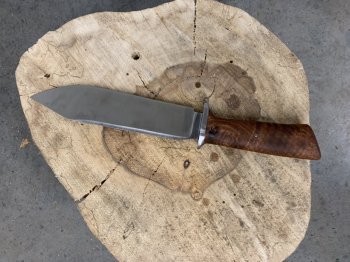

Jon Buescher
The small knives have mesquite spacers and the bigger knife has all mesquite

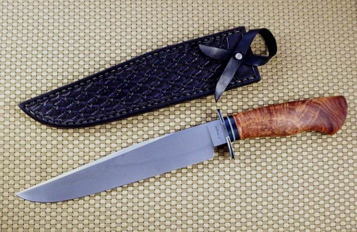

opaul
I made this one with mesquite awhile back. It worked pretty well and didn't really cause any issues.
Not to derail this tread, that is a beautiful set up. I'm intrigued by the sheath. The knife is held in place by the loop, which is attached to the stud pin, and the loop being independent of the sheath. What size stud pins do you use for that? It looks great.
