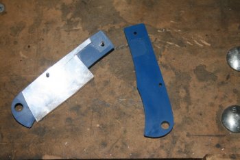

Well milled my first liners today. It worked out really well. I did the plastic outline thingy to make sure the pattern was the same on both sides and they line up together really well. Thanks for all the help people.
Well you asked for it. Here is one showing the bit of plastic I cut out and the final result on the other liner. I just used some of the plastic that all tech goods seem to come in these days that is impossible to open even with a knife :) I drilled some holes in it through the liners so it was possible to line it up easily on both sides of the knife. Scribed where it should go and milled it out.

You'll have to wait at least a week. The in-laws are coming to visit this weekend :eek: Everything is ready to do the final hand sanding and then assembly. It was a bit frustrating to put it aside knowing it is so close.
