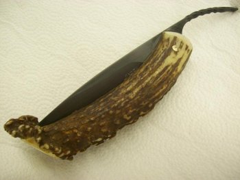

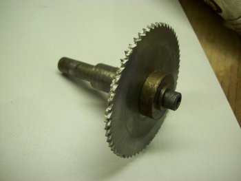

I use a jewelers saw in a mill to cut the slot. This one is 3" o.d. x 1/8" thick.
