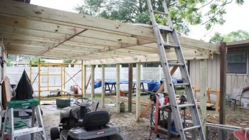

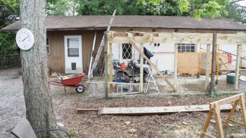

side area
I replaced an old tin roof and cleaned it up well. It will hold all my welding equipment.

Tactically sharp, Nice looking shop, I started to go that way but I am still hoping for a press, and if I can get it quiet enough a small air hammer. I have a 14' x 14' now and it is so full I have a path that has a branch over to my tool box. I am adding 8' to the front and was going to add 9' to the side but the inspector has problems with my design so I guess it will be 14' x 22'. The shop will have heat and AC so I can work year around. A dream come true. I know a lot of guys work in hot and cold shops but I am not that hard core. Ed
