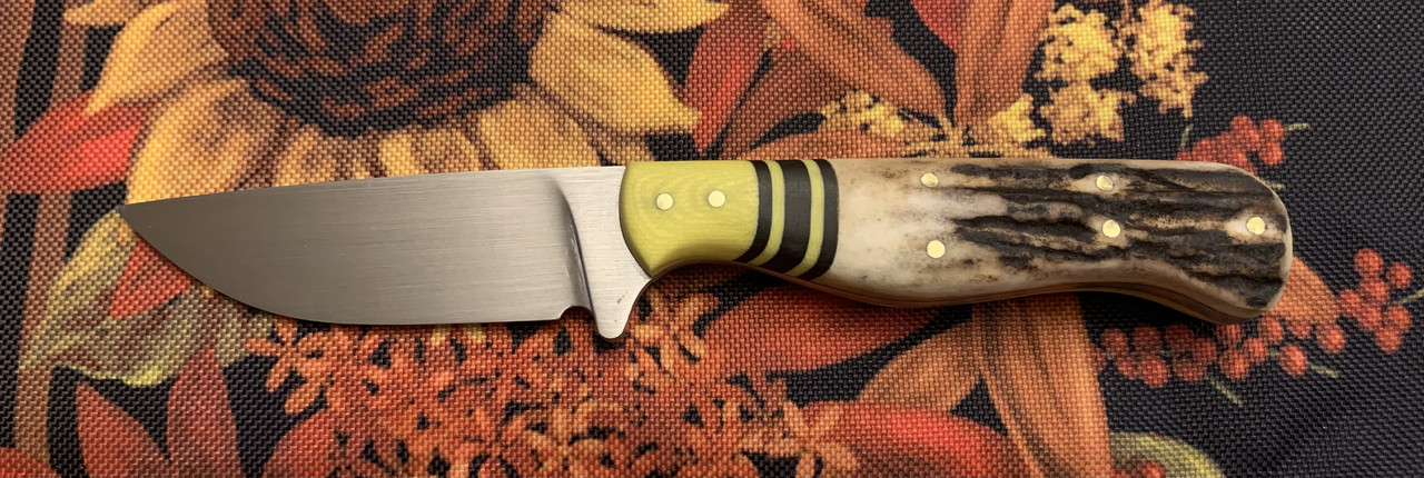

Here you go Sean. A yellow g10 bolster with stag scales knife.
Dennis, I'm still a newbie, so is there a tutorial somewhere explaining how to make a layered bolster like this? I can think of several ways this might be done, but something tells me there's one right or best way. Is it simply a matter of gluing up the layers and then shaping them?
I am not sure if there is a right or wrong way to make a layered bolster. The way I made this one was attaching the biggest/front part (yellow) to the knife. I let the epoxy cure overnight. I made sure to clean off all the epoxy from the back of the bolster so the black/yellow would rest tight to the big yellow bolster. I then attached black/yellow/black x2 to the big yellow bolster on the knife. Again, one side and I let the epoxy cure overnight. Next day, I did the other side. Then the stage on one side. Then the stag on the other side. Took me a week to epoxy the handle together. I missed by a wee bit getting them perfectly lined up.
Many thanks. That helps.
