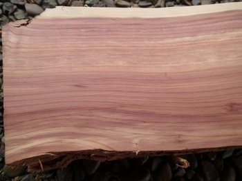

What are your thoughts on using Juniper for knife handles, and has anyone had any success with stabilizing this wood for such use?

I have worked with juniper in the past. Would it be good after stabilizing, I don't know, but as it is it is a far too soft wood for knife handles.

Thanks guys. There isn't a lot of information regarding the use of juniper for knife handles online, and I am not using a piece of burl, though I would assume that juniper burl is very similar to redwood burl as far as hardness is concerned prior to being stabilized. What little info I did find on stabilization shows that it may or may not work depending on the procedure and chemicals used, as it may continue to weep long after it's been done. I guess I'll go guinea pig here and get some done and see how it all turns out.

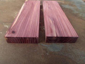

I have had some Juniper stabilized in the past.
It responds a lot like red cedar. Not much of a weight gain and weeps afterwards for a few months.
The weeping is something that can happen with oily woods. The block will be kind of sticky and gets a satin instead of shiny finish.
Usually after letting the stabilized piece sit for a few months it is good to go.
If used unstabilized Juniper is very prone to cracking along the grain.
I managed to do a test run in Cactus Juice with a set of Juniper scales. The results seem to be satisfactory. There was not a lot of weight gain, the finish is uniform and smooth, the color was darkened a shade, and so far there has been no weeping. The hardness seems to be equivalent to stabilized redwood. I will craft a handle from this set and see how things work out in the finishing stages.
