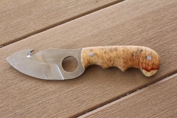

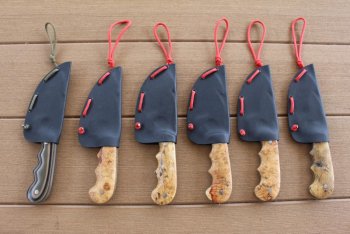

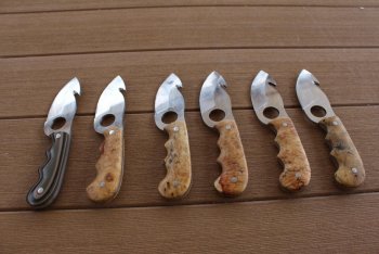

I've been working on a bunch of stuff, mostly some 440c skinners with a finger hole, probably have made 12 of them so far. Here's some pictures of them. Some have box elder burl, G-10, oak burl for the handles with loveless and epoxy holding it together. Sanded to 600 for the finish and each has a gut hook.

Hey Wayne, those turned out great! Like how you rounded the heels - will have to try that. And fantastic score on the etcher- my etches got a lot better when finally got a real unit.

Great looking knives Wayne. Is that a flat grind on those? They look very functional and practical for everyday use.
I also like that spalted wood. What is it?
Wayne Bensinger
Yes, they are flat grinds, the first one I did I tried a hollow grind, but with the tight radius on the blade, I wasn't having any luck. The wood is box elder burl. I didn't think at first it would look so good, but now I'm sold, it's a great look. Thanks guys.
