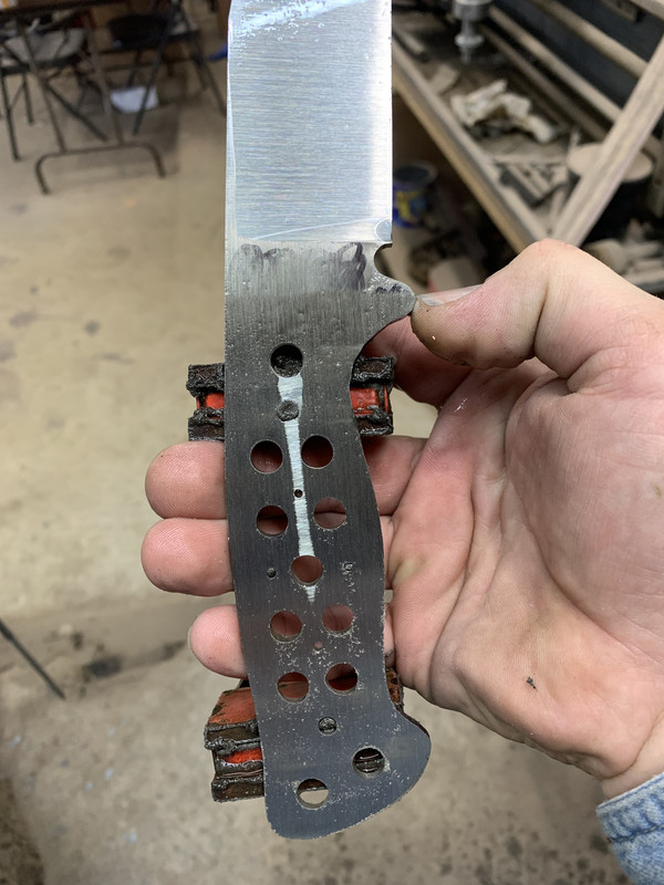

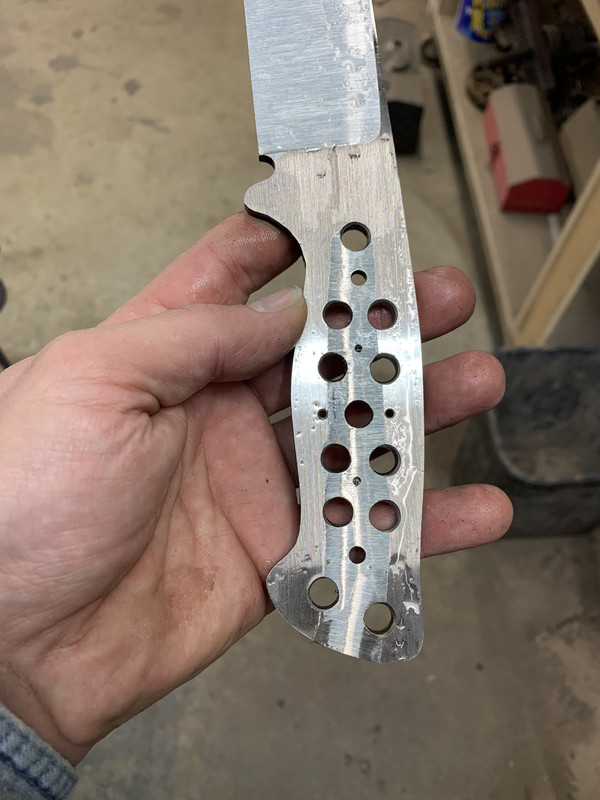

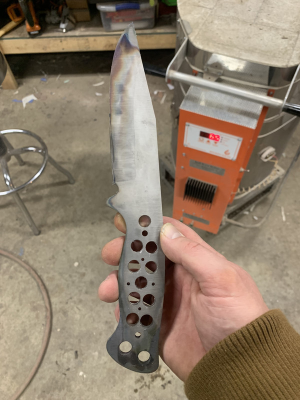

After hearing that Kaleb had a pretty good start on his knife, I figured I better get started. I traced the pattern onto my steel, .200” AEB-L.
Next, I cut out the profile.
Here I have cleaned up the profile, marked and drilled the pin holes.
Finally, I drill epoxy holes in the tang.
Up next is heat treating as soon as I get parts in for my kiln. Hopefully this week.

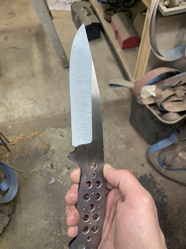

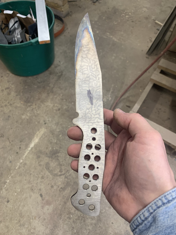

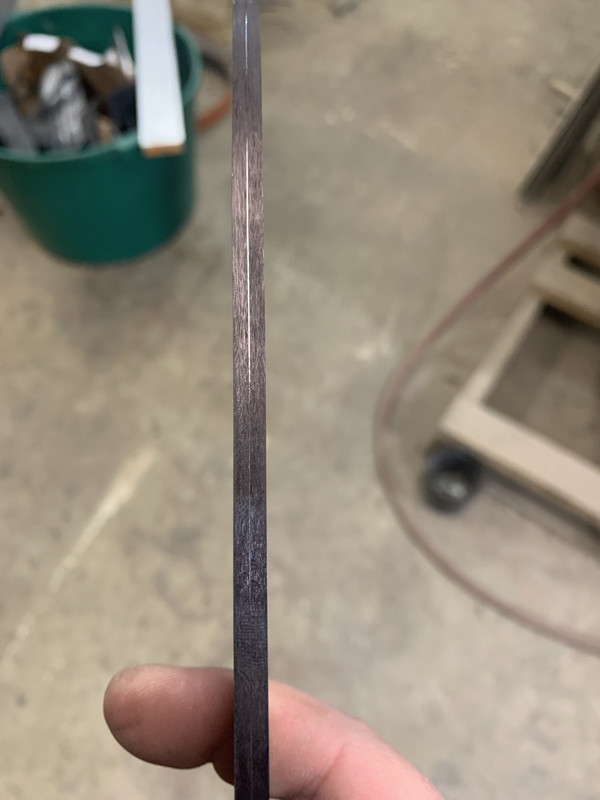

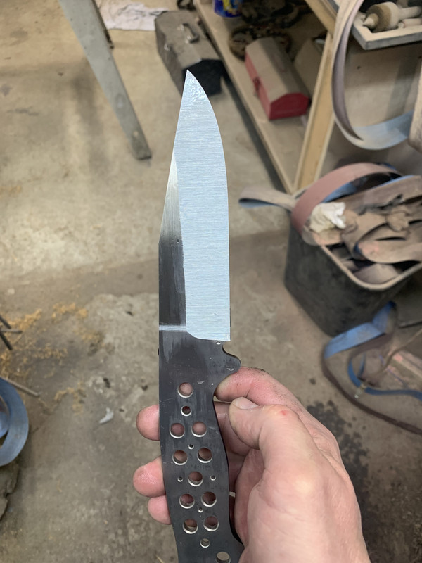

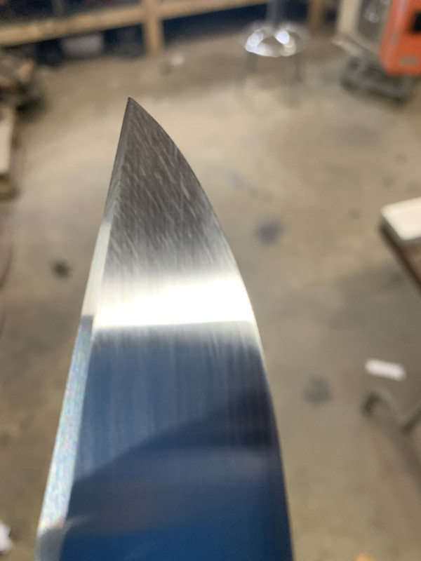

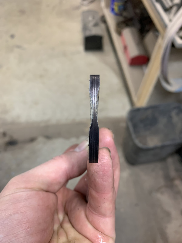

After tapering the tang, I finished grinding the blade to 600 grit, and ground the swedges in. Next was hand sanding. This is where I discovered a problem. I found lines in the steel that won’t sand or grind out. I’d guess them to be alloy banding, but I’m not sure that’s possible in AEB-L. Whatever it is, I’ll be starting over with a new blade.
