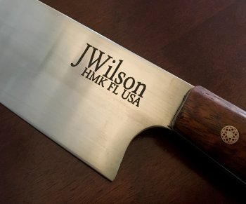

I tried something new for my makers mark. A customer wanted some extra personalization on a knife and I didn’t have time to get a stencil made. My solution was to have it laser engraved. While I was at it I decided to do the makers mark as well. I drew this one up quickly right before heading to the engraver.
Tha mark is about twice as big as I had intended. That’s my fault for being in a rush and not proofing it on paper for scale. The customer didn’t mind but i’ll still reduce the size going forward.

It doesn't look bad but I can see wanting to go to smaller side. Love the knife! What does the HMK stand for John??
I've drooled over the laser engraving in the past, but the price of the required laser is a tad on the expensive side. That does look really good. Great job.
Thanks guys. Yes, it is on the WAY TOO LARGE side. Again, that's my fault because I didn't proof it for size and the guy doing the laser engraving simply pulled up my file and hit "print." Once the laser starts firing it's too late.

HMK is "Hand Made Knives" it correlates to my facebook page which is J Wilson Handmade Knives. I went with HMK over HK for no other reason that I liked it better and thought it looked more interesting.

It may be a tad on the large side but, I wouldn't go as far as to call it morbidly obese!! o_O:p
John, I have always said the harshest critic of a knifemaker is usually the maker himself! That usually makes for a great knife, like this one!!
I think the size looks good on a bigger blade like that.
