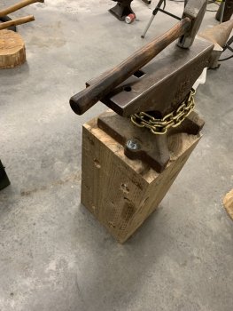

Chris Railey
Mine is very simple. I took four 10 x 10 posts (I am lucky enough to have a friend with a sawmill) and ratchet strapped them together top and bottom. Then I mounted my anvil to the top and added hooks and stuff to hang my hammers. Then a wrapped a piece of logging chain around the base and went to beating hot steel. I get no ring and it barely moves even when I use my big hammers. Will your anvil be indoors or open air?

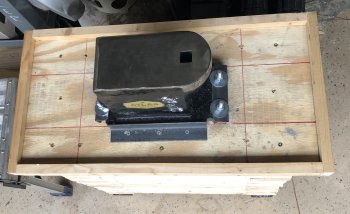

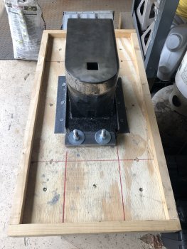

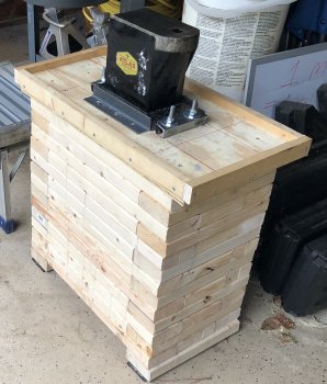

John Wilson
I am a total noob when it comes to forging, so please don’t assume this design had any form of intelligent design based on experience. But so far it is working great for me.
I used 2x4s to make a Lincoln Log box. This also allowed me to put 2x4 runners on the bottom so that I can get a dolly under it to move it around. Then I filled the center cavity with concrete.
The stand / concrete came out to about 230 pounds. My dinky little anvil is about 70lbs. So 300lbs mass altogether. No ring, and it doesn’t move when I hit it.
Having a top tray to lay hammers and tongs has been extremely handy.

John Wilson
For the price I am very happy with it. It is definitely a compromise anvil. As I mentioned, I don’t have a ton of experience forging on various anvils so I can only tell you what I like and don’t like about it.
Pros:
All of the mass is in one big chunk centered over the base instead of a heel and horn. Atlas says this 67lb anvil is therefore the equivalent of a 120lb anvil. I have no way to verify that but it seems logical and legit.
Each edge of the face has a different radius. This is useful.
No horn to walk into in my tiny shop.
Cons:
No horn, so limited usefulness in general blacksmithing.

Chris Railey
Here is mine, like I said, very simple. If you will be moving it around I suggest building one like this or the other two above, the mount two HD wheels toward the bottom of the heel side of the anvil stand. That way the stand will “stand” flat the all you have to do is lean the whole thing back (toward the heel side) and the wheels touch, then you can roll it where you want easily. Think like if it were a hand truck. 8F5324A7-46DE-40B3-80BE-58611B07C0E6.jpegBA40DC46-781E-46EF-A4BC-8102C559FE0F.jpegEC0FE0D0-F486-4D7F-AFC8-D54F6D694562.jpeg

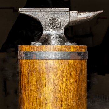

EdCaffreyMS
"The Montana Bladesmith"
Wood is the only way to go IMO....and if you can in any way get your hands on it..... hardwood such as Ash, Oak, or Hickory!
4- 6" square whit oak ties, surrounded by 2" thick X 6' wide white oak board. About 12lbs of 5/16" deck screws, and then metal banded. After I got it all done, I found an old can of teak oil, dosed it down, and let it dry for about 3 days. Love it!
My biggest enemy in Montana is the low humidity.... if you look closely in the first pic/background, you can see the oak ties under my Say-Mak air hammer..... dried out, shrunk, with that huge gap between them??? Those ties were put there 4 years ago....and when installed they were "dried" by Indiana standards (where they came from), and fit nice and tite...... now they look like an old wooden bridge, about to collapse! :)
(That's the 509lb Peter-Wright sitting on it)
The hold downs......
And the final setup, with all the hammers hanging.....
