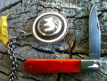

Looking for constructive criticism on 3rd slipjoint.
slatercreek
I am new to the forum. Thought maybe I could get some feedback on my slipjoint. 3rd completed. Not a knifemaker by any means. I just enjoy a challenge. Designed from scratch.
Looks pretty clean from here. Any gaps between the liners and spring? Snap good? Blade centered? Flush in all 3 positions?
The only disappointing thing is I didn't quite get the pivot pin hidden. Snaps open and shut. Blade centers up nicely. Had a little problem with that on the first two.
Nice work. Next time, use a drill one size larger than the pivot and make a slight counterbore on each side of the pivot. That will let the pivot pin expand and fill the tops of the holes.
For instance if your pin is 1/8 (.125) use a #30 (.1285) drill at the top of the hole each side.
Thanks for the comments. I believe the problem on my pin may be that I left to much excess pin stock sticking out when I started peening. I think this caused the pin to swell prematurely and not properly fill in the pivot hole. I could be wrong but that was one thing I got right on the first two. I would rather be lucky than good any day.
I think it looks good for your third also.
You can replace the pivot pin if you want. Just punch mark the center of the pin and drill part way with a smaller drill bit. I use a 1/16 drill bit for a 3/32 pin and drive the old pin out with a 1/16 pin punch.
Taper the holes like Don Robinson said or use a tapered reamer. I use a carbide reamer and taper it down about .030. You want it deep enough that you don’t sand off that much when finishing and not too deep that the pin will not fill.
Clean the hole good and sand and clean the pins, I use acetone. Polish the face and peen end of a small ball peen hammer and just use it for this. Peen it with the flat part of the hammer to swell the pin in the taper instead of mushrooming the top with the round peen end. Use the round end to peen the handle pins where you do not want the pins to swell inside the holes.
