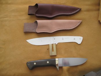

Hello all, I am starting on a couple loveless (or dozier, or just plain old style hunter) drop point. I have done one knife with the guard like this, but it didn't turn out as well as I hoped. My question. Do you file into the tang of the knife a slot for the guard to fit into (I am guessing about a 1/4 in.) or do you just round the tang over so that when you slide the guard on you get a nice snug fit. Looks like here they filed in a slot, and if that is the case, how do you do it? Any help would be appreciated, Thank you!
This is the way original Loveless guards were done, the one in the picture has a flat bottom, others were done to the radius of the mill bit, had two pins and were soldered, this is an old pattern. Deane
Ok, that is actually not what I did. I didn't have a handle stop, I just had a radiused flat spot where I put the guard. I used JB weld to seal it, and peened the two pins to hold it. Thanks for sharing, that is initially what I was trying to figure out. I see that is what Mr. Miller said, I just didn't quite understand him.
