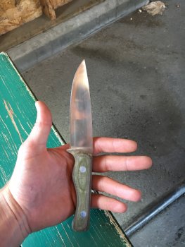

I currently make my handles out of a G-10 like material I made in my garage, it consists of layers upon layers of canvas dredged in auto body Fiberglass resin then pressed as tight as I can clamp it. It produces a material that seems durable and can be attractive if properly finished. Does anyone do anything similar? If so what suggestions do you have for me as I am preparing to make a few more pieces. I have 3 more blanks that need handles. DF8572AE-14A9-4DD4-B92A-98479E71ECC7.jpeg
Making it yourself can be a fun project, but it's actually cheaper to just buy it ready made from one of the supply outfits. Generally I buy most of my synthetics from Masecraft supply.
