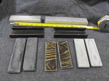

Started yesterday working out how to make micarta scales, first test I used 15 layers of fiberglass cloth, set for around 24 hours, which gave me this ugly thing
the 15 layers was no where near enough to try allot of shaping with, as its only about 1/8th of an inch thick, though I decided to go ahead and hacksaw it a bit and use some files to shape it a little, and see about drilling holes to match my practice bar
this thing is ugly as can be
few observations made: the fibers did not become impregnated with the epoxy and fray on any angled sanding, More epoxy is needed to make it more uniform, MUCH more layers of fabric, Needs longer set time(paper towels I used to cushion against my vice stuck to it), need more pressure on the clamps to bring the layers together better. Also: fiberglass is itchy, and I will never use it again. I'm really glad I only did a small one with the fiberglass cloth, It would have been a frustrating waist of time to do anything bigger.
but, I Just got back from a shopping trip and snagged a yard of tan canvas material, I'm going to cut out around 35 12inchx2inch strips and epoxy them tomorrow. I look forward to applying and advancing what I learned from run 1!
also does anyone have a good recommendation on how to finish up on micarta?
