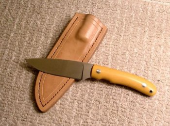

Guys, Thanks for all of the replies and help. It might be the old linen micarta. It was available about 20 years ago. No photo of it yet, because I have not finished the blade polishing and sharpening it. Right now the blade is covered with blue masking tape because it already bit me once, even though it is not sharpened completely.:(
I will take and post photos as soon as I can of the knife and the piece of micarta.
