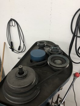

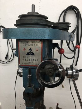

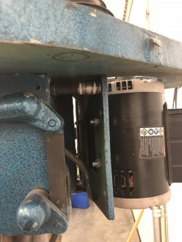

I bought a Mill/Drill for a very! Good price from my friend Bruce Bump. My only gripe is that it is a ROYAL PITA to change the speeds on it. Could I get a VFD for it for a reasonable price? I’ll take a few pics and add them
Pics as promised it took me quite a while to get the speed changed and I would love to be able to set the speed with a quick adjustment of a knob

To put a VFD on it you need to change the motor to a 3 phase motor.
