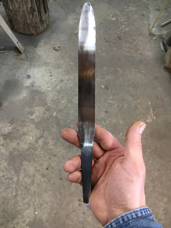

I spent a little time on this one yesterday. I got the faces and profile cleaned up.

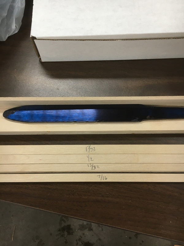

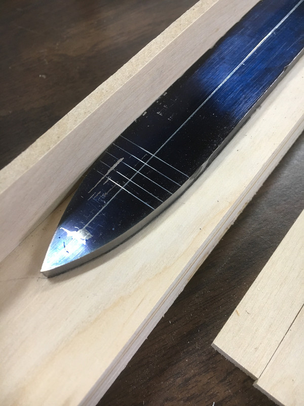

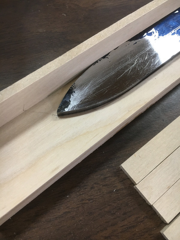

Next, I made a jig to be able to mark the center of the blade.
I cut some strips at different widths to use for marking.

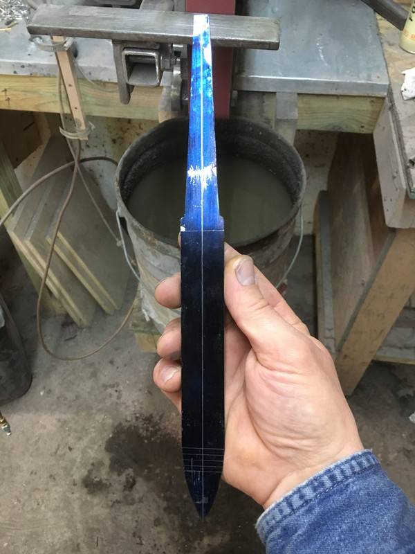

I also put some marks across the blade to use as reference points when I ground the profile of the tip. Then I used the jig to draw the profile of one side, then flipped the blade over to compare the other side.

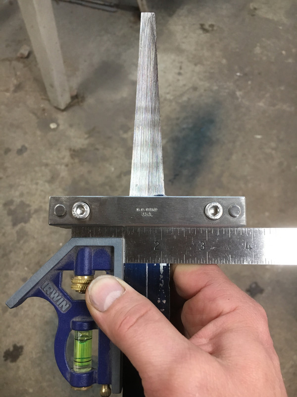

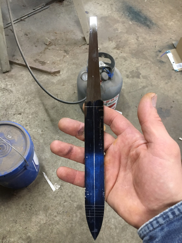

The next step was tapering the tang. Here I have the profile tapered.

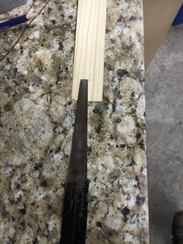

Now to taper the other way. When I grind this taper, I lay the blade on my granite top and use a shim to make sure both sides are tapered the same.

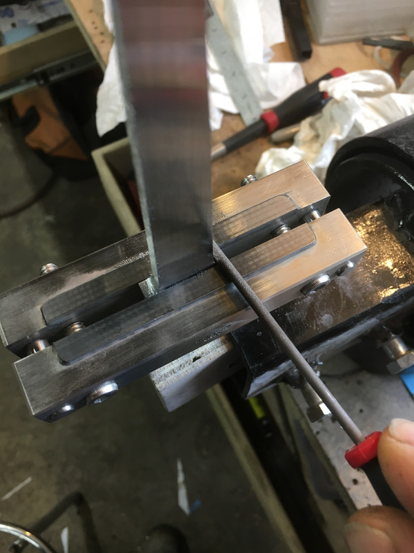

The last step I finished yesterday was cleaning up the shoulders. I use a file guide, squared to the blade, to grind them in, then finish them up with files, rounding the corner so I don't crack the blade in the quench.

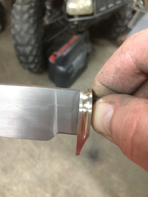

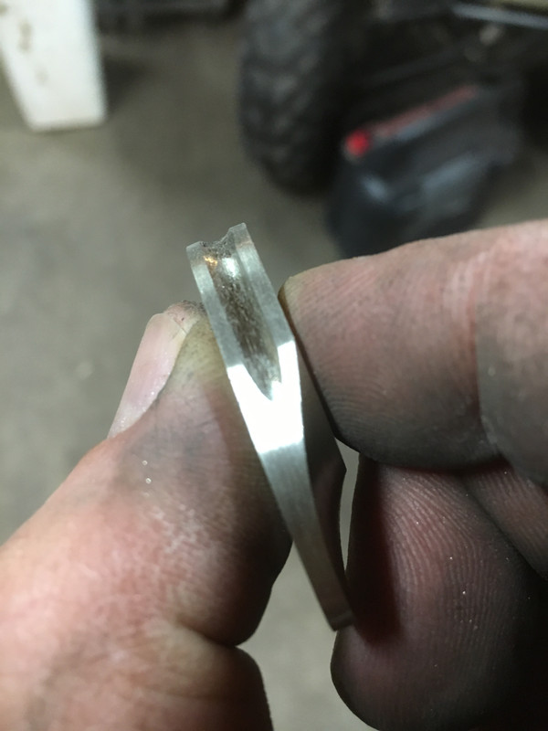

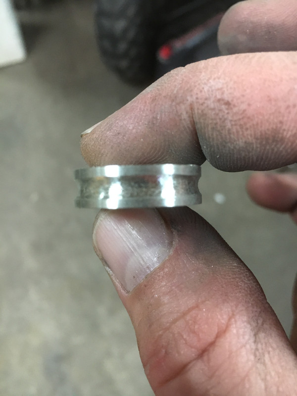

Tonight, after I wore myself out hammering on the billet for the guard, I practiced putting a flute in an old guard I had messed up. Built my confidence up a little before I do the flutes on the damascus parts.

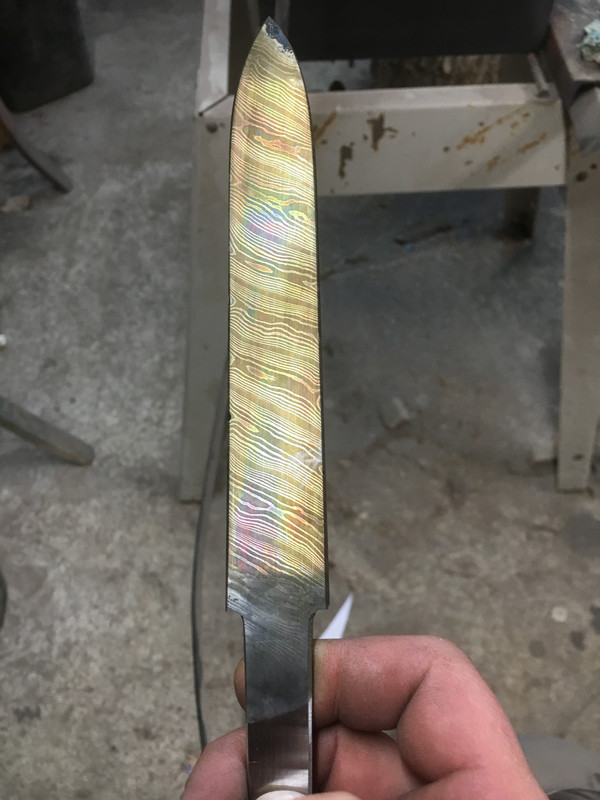

Then I had to do a quick etch on the blade to see what it looked like.
Looks really good! Looking forward to the finished project!
