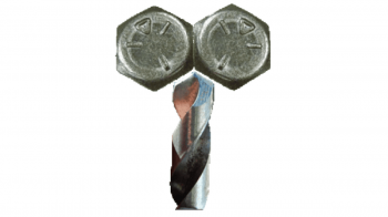

One thing I noticed recently is to use nuts to check the angle of the edging, as shown in the attached pic.

I think I'll give this 59 degree block of wood method a try. Thanks for the tip.
