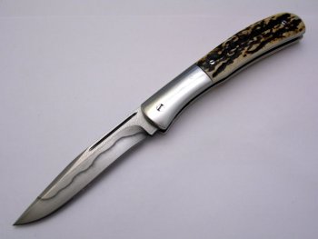

I make liner locks instead of slipjoints, no matter, but I started using O-1 because it was readily available in ground flat stock, very inexpensive, easy to grind and heat treat. Now after a few knives I still mix in O-1 with other blade steels. Dan
