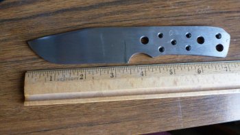

The latest noob mistake. In an effort to even my bevels i some how pushed back my plunge line about an 1/8". Oops. At least the bevels are some what even. I drilled the pin holes for some stainless steel tubing. Some how a larger drill bit found itself in my pin drawer and I drilled the holes over size. Oops again.
Jake
I just spent an entire day correcting mistakes. I spent nearly 10 hrs at the grinder carefully reprofiling 6 blades that were screwed up one way or another during heat treat. 4 severe warps, 1 minor warp and 1 broken tip and surface cracks on all but 2 of the blades. Man, post HT reprofiling sucks! Grind for 1-2 seconds then dunk in ice water, and repeat about a billion times
